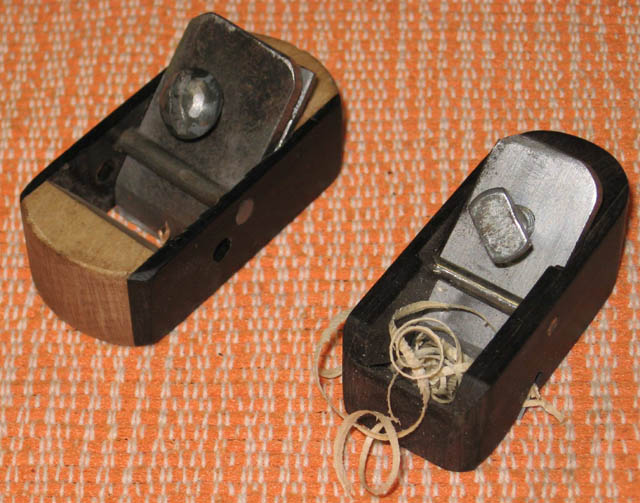

I made these a while ago.
The most dificult part is putting the pin for the wedge at the right place and equal each side.
Mine do not have a wedge but a screw adjustment.
For the blade, I used an old spokeshave blade (too short for the spokeshave)cut in half with a cuting disc
